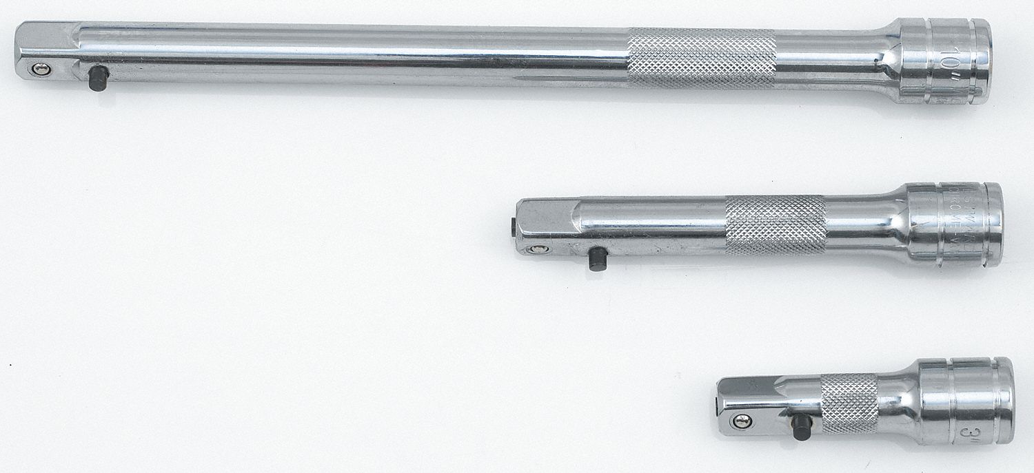

I've got locking extensions from Mastercraft (a Canadian Tire house brand - most likely made under contract with Apex) and Westward (Grainger's house brand).
Of the two, I prefer Westward with it's button-style locking mechanism and bit of knurling:
Over Mastercraft's collar mechanism:
Also, here's Gearwrench's version (I think you can see why I assume Mastercraft's were made by Apex):
They both work great though. I'd probably just deal-shop if it were me.
12XK96_AS01
I have broken one - but only because I needed a super-long locking extension to get at a recessed driveshaft bolt and I chucked up one of my long chrome Mastercrafts in my big impact. The plastic part of the locking collar didn't survive.
Pretty sure they share the same lineage lol.
