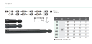

Just be aware that has a pin lock, will work best with (impact) sockets that have a through hole in one of the retention notches.
Here are some off-brand stubby’s with ball retention: https://www.amazon.com/Stubby-Impact-Socket-Adapter-Inches/dp/B0DKVG6L51?tag=atomicindus08-20
(I’d prefer the Apex, though … ;) Neat find @Winterborne !)
Kind regards,
Olli
That's something I need to consider, none of my sockets have the hole so retention might be an issue. Maybe I'll try the off-brand pieces and see how they work.

Add a "B" suffix to the Apex part number for ball retention.
Be aware these are industrial power bits and they have a little different heat treatment than impact rated bits.
If the pin lock is acceptable, Irwin makes one very similar to Apex. I bought a 10-pack at a local industrial supply.
Looks like there is a seller on eBay that has them at a reasonable price:
https://www.ebay.com/itm/274838134630?msockid=1acb3a2812de6bc3157f2d88139d6ae7
Another option is to make your own. Its easy to add a power groove using a round file.
