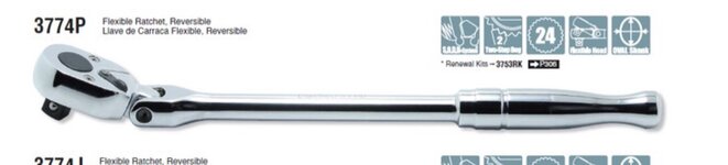

3/8 or 1/2? Easy - 3/8! I use my 3/8 long flex ratchet more than any other tool now. This Snap On is my favourite. I still have all those 1/2 inch drive sockets, but most times when I’m using them I’m fine with a decent breaker bar and standard ratchet. I do have long 1/2 inch ratchets, but don’t use them often in automotive work.EB9607F5-9FB1-4723-AFC9-132F3ACE1864.jpeg
This Koken is 80% of the Snap On for 35% of the price.
If you’re working on things like bicycles, motorbikes and garden equipment, then that’s just even more in favour of 3/8, if not 1/4!
But don’t think you have to replace all those 1/2 inch sockets. Supplement them with some 3/8 in the sizes you use. If you work on typical euro stuff, you can probably get by with 8,10, 13, 16, 17, and a few hex and Torx!
