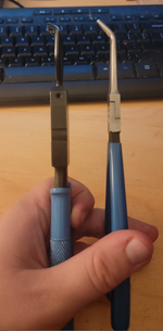

I've already posted about these Merry L60-200 pliers a couple times, but not as its own thread.
At first, I thought they would just fit a niche need here or there, but over the last couple months, I seem to be using them everywhere.
The long thin reach and bent nature of them is like having miniature fingers that just seem to save time on every project.
Examples:
Disassembling a car radio - saved time in disassembly as it could reach around and deep to plug and unplug ribbon cables, that tweezers are too weak for, and 'normal' pliers are too big for.
Removing supports from 3D prints - intricately just snakes right around to where the supports are but rigid enough to give er' the beans to rip the supports loose.
Installing automotive door hinge grommets - through a small access hole that otherwise would require substantially more disassembly.
Now its got me thinking, what other iterations of similar tools are out there that folks here would recommend?

Where did you buy these? What is the part number for the ones on the left? They have them on Ebay for $33 plus $20 shipping. Are they available domestically?
Do other manufacturers make something similar? I get lots of needle nose pliers with a search, but nothing this thin.
Edit: the part number is Merry HS175C Coupling Tool

noid
Jul 15, 2010
1,341
This where I got both from, you're correct on the PN. The ones on the right are Merry L60 and HS175C on their website.
