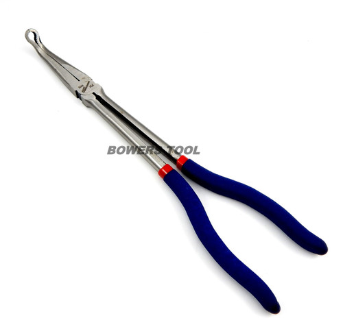

So I opened my new Blue Point hose grip pliers today and I am a bit disappointed in them. First, they are made in China. Not a deal breaker but I thought Blue Point products were made in Taiwan, I guess not all of them. Second, they don't seem be very well made. The grinding on the flat sides where it says "China" is not consistent. The one in the center the grinding is sort of ok, the one on the bottom skews to the left and the one on top extends out more than the other two. Also the tips don't meet up evenly and the grinding on the rounds parts is looking chunky. If I had paid full price ($83.50 according to SO website) I'd be even more disappointed. Everything else seems fine about the pliers, decent handles and I am sure the steel is good quality but I expected the finish to be better considering the price. Any of you with BP pliers finding the same thing or is this uncommon? I thought they were going to be like the Icon hose pliers.
20240329_225023.jpg20240329_225127.jpg20240329_225139.jpg20240329_225228.jpg20240329_225246.jpg20240329_225254.jpg20240329_225315.jpg
Wow those bluepoint are a sloppy effort besides the diamond pattern teeth .
Bluepoint cheaped out quite a lot in recent times (wrenches old era vs new good representation of that).
You can find better on eBay if take time hunt & get bit of luck. I had a 6pc orange handle long reach pliers set off eBay some years back that had 3 hose pliers in the set & worked out just over 6 bucks each and general manufacture finish better than the bluepoint or icon .
I wouild return the bluepoint, use what you got while looking out for used MACs or fairly good manufacture cheap effort .
One thing this thread highlights is the HF 3pc set is very good value usable tool .
I can pretty much guarantee they didn't have a better finish than the Icon. The regular Pittsburgh set? I can see that, but not the Icon.

Wow those look particularly poorly made for something costing that much and sold through SNA!
Toold_up
Feb 9, 2019
640
Attached
They are probably a chinese knock off. Everything you buy is suspect anymore...
Anything that is popular is ripe for a rip-off. Buy a product from cheap-junk.com and low-and-behold it's not from the OEM. I've seen stories about people buying Mitutoyo digital calipers from amazon and what they get is not the genuine product. It's a chinese knock off that looks close enough that the robots working in the warehouse stock the junk in the same bin as the good stuff... Shame!
I know the OP bought his used from faceialbook but where did they originate from?
