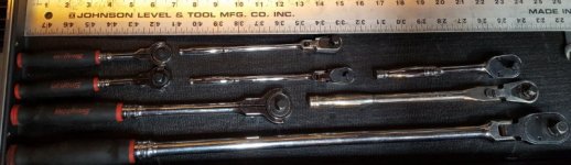

Who makes a good quality 1/2" ratchet that has an absurdly long handle on it?
Specifically working inside the cutterhead of our silage chopper, I can't get a 3/4" drive ratchet in there. Unless someone knows of a 3/4" ratchet that has a slim head and is somewhat fine tooth count?
I've pretty much ruined the handle on one of my 12" 1/2" SK round head using a 36" cheater pipe on it. The mechanism has never missed a beat, but the handle has been bent quite badly to the point the chrome is flaking off. After being bent back and forth a few times I would imagine soon the handle might entire fail. I've shattered the mechanisms of a couple of lesser quality ratchets long before the handle bent.
I can't utilize a breaker bar in here even with a 12 point socket I just don't have enough options for placement of the socket and still have the swing needed. Torque of the bolts is around 350 ft-lbs, and with added corrosion they are quite tight.
So to recap, long ratchet needed! Either super long 1/2" drive or extremely slim head 3/4" drive.

I think Snap-On makes the longest but if you want a slim profile get a Matco. They still go to about 24" and their heads are about the thinnest available. Their 1/2" is the same thickness as most other brands 3/8" drives (including SO).

The longest ratchet I have is a Matco 24" flex head.
It is very strong, and I am not brand loyal either. I really like it and have used it in some high torque scenarios.

I have a non locking flex head 24" dual 80 snap on with comfort grip as do dozens of other mechs as it one of the nice tools they will actually buy for us at the factory. It gets used regularly by everyone and the 3/4" ratchets rarely get used any more. I have actually hung off of it (230 lbs) and bounced so 500ftlbs? I bigger sizes most of our sockets are proto impacts. I have yet to see one of either broke in the 5 years we have had them.
It pretty rare for me to get out my personal 42" 3/4 snap on now.

May not be the 'longest', but my 26" Snap-on flex SHLF80A has never left me wanting for one even longer. If I did need longer than that we have entered 3/4"dr territory.
