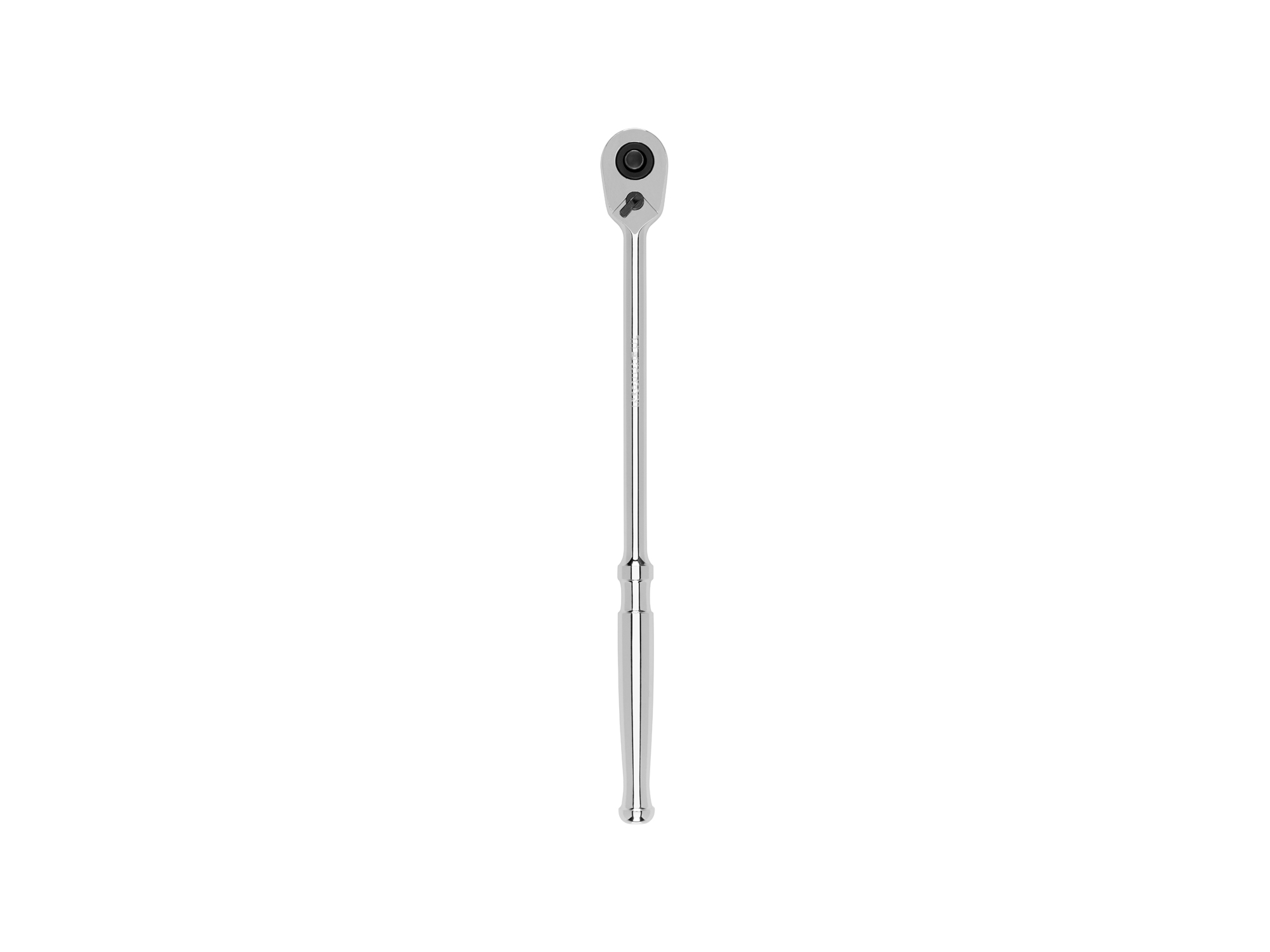

OP here is my Tekton set, all 3 drive sizes in long length.
