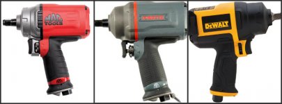

For home use, mainly tire rotations, other vehicle maintenance.
Don't want to spend a ton.. but want something quality. Was thinking of scooping the new Dewalt DWMT70773L, but it's new.. and unproven. It's apparently a copy of this MAC AWP050 but the Dewalt doesnt have the Titanium housing.
Any other hidden gems out there?

How is the balance? same as the other 3 guns?
