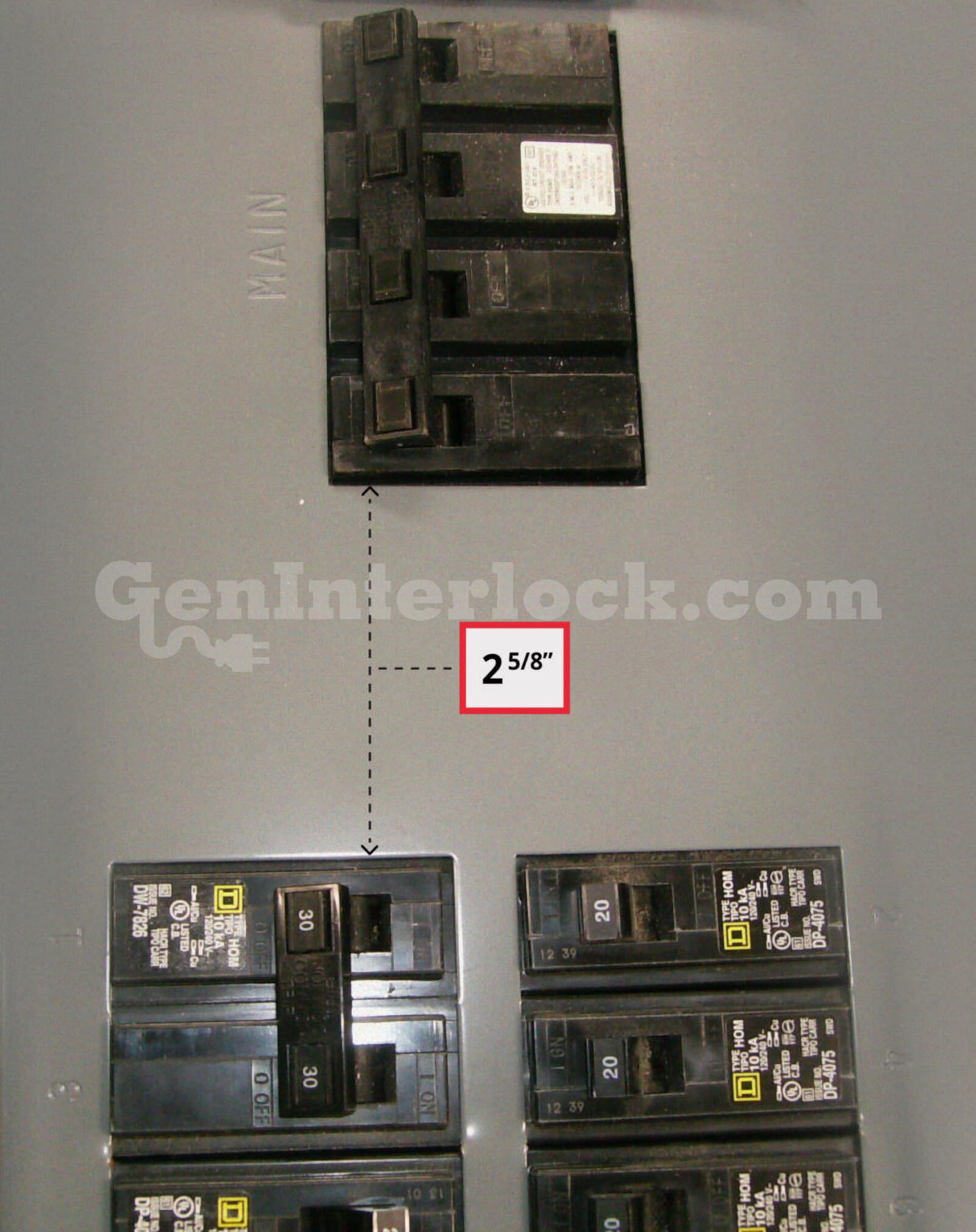

Your probably looking for a generator interlock kit for your main panel.
I would go that route but my old cutler hammer panel has a 100a breaker in the top positions that takes up both sides, it powers my electric furnace, so that is in the way.

Install a 30A Power Inlet Box (PIB) on the exterior of the house and a Generator Interlock Kit specific to your main panel. A 30A 2 pole cb generally needs to be in the upper-most righthand location of the panel so the interlock kit can manage main cb and the 30A cb.
You may need to relocate 2 cb's to elsewhere in the panel if that upper location mentioned is already used.
This is the simplest method, very clean and safe.
