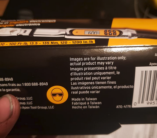

Don't think you have the newest Gearwrench torque wrenchs. The newest are made in Taiwan. The whole electronic housing is covered in metal as opposed to rubber/plastic. Pretty beefy.
https://www.garagejournal.com/forum/showthread.php?t=438565

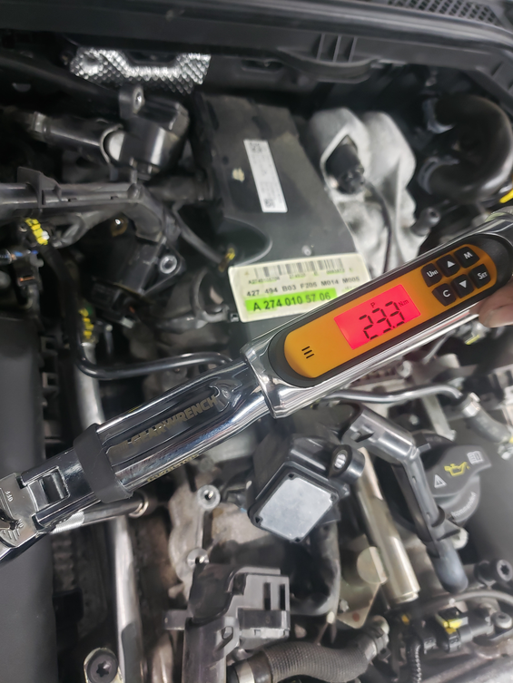

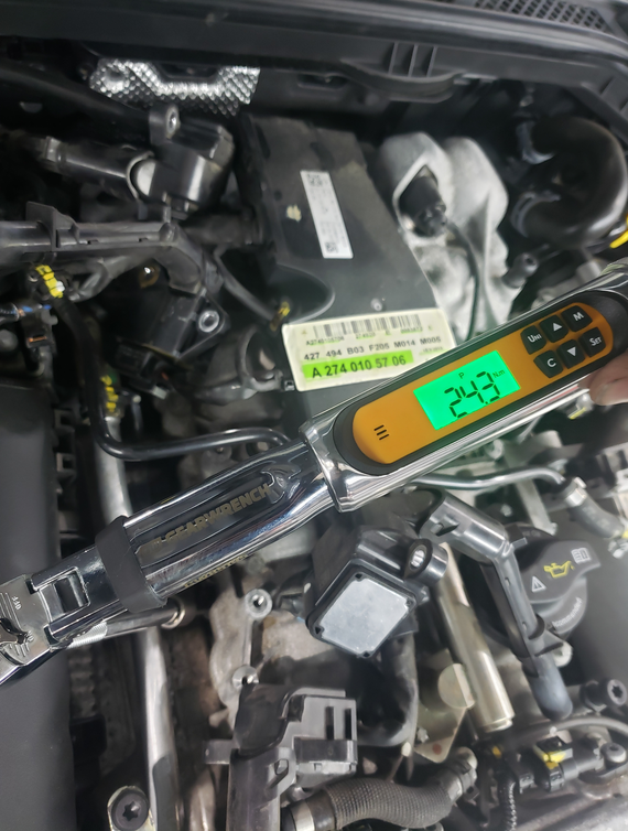

That's the Gearwrench torque wrenches that I have in both 3/8" and 1/2". According to the Gearwrench guy at SEMA they are made by SATA which is headquartered in China. The guy at the official APEX torque wrench calibration place (Barry Sperlock at Angle Repair & Calibration, 175 Angle Drive, Beckley, WV 25801) told me the same thing. I traded in two of the original Gearwrench digital torque angle wrenches (the ones that ate batteries in a matter of days) for these plus something like $120 each. This was the deal the guy at SEMA gave me after I complained about the original wrenches.
