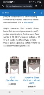

You don't know that. These can be had in flavors up to 35 CFM!
Well, have one of those, and 2 more blast cabinets....I'm well aware of the requirement.
OP is not using a blast cabinet, he's spraying paint and using an impact. A little portable 30 gallon deal would likely suffice, but since we all like overkill, a 3-5hp 60 gallon will be perfect with a smaller footprint than an 80 gallon.
