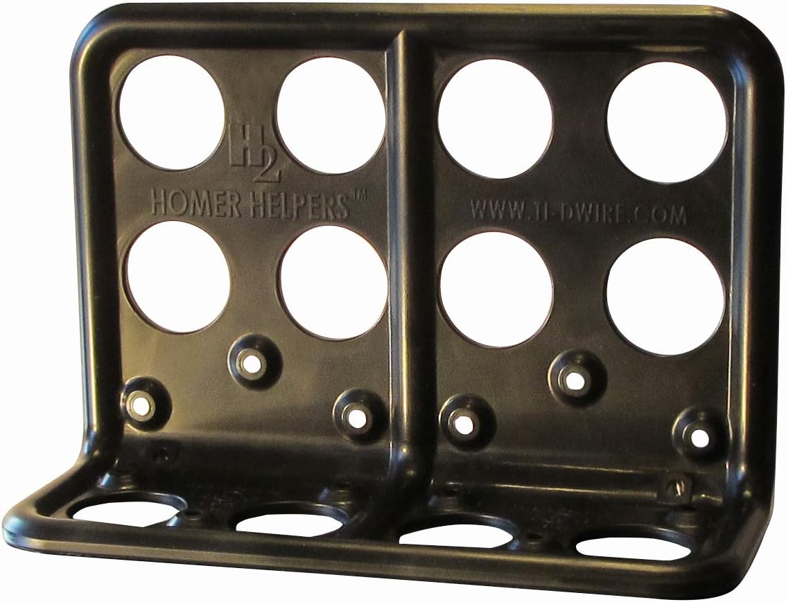

Thanks
I had seen something like this for new construction, but was wondering if there as something like this for retrofit
of course this wouldn't work because those cables would need to be rerun
