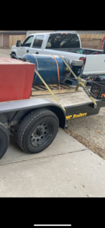

My compressor is a 5hp 22scfm (or 16.5, label says both. Can’t remember)84C9560F-E6B9-49AC-83E1-33DF090C45A7.png
