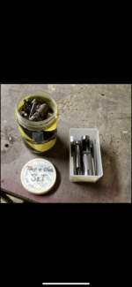

sounds like going the hf route could end up being a headache if I break the tap.
I need to cut new threads on a couple of projects. One is drilling and tapping threads on a 1/4” hot rolled steel plate. The other is drilling and tapping an old vise jaw.
there is a guy near me selling an old ACE SAE set of what looks like mostly taps for $25. It’s made in the USA. No case, just stored in a jar.

You would wish that a broken tap is only just a headache.....

Three or four years ago I bought the Amazon set (more or less, don't recall the brand, but they all seem the same). They're okay in a pinch if as others said, you go very slow and remember to use lube. You'll also find the tap handles to be **** as they fall apart if you look at them funny. If I'm very lucky, I only have to tap something once every 6-9 months or so but I decided to upgrade. What I did was go on Ebay and find a vintage Ace Super Set from the 50's or 60's and USA made for about $50. They're what my dad used to have and they work perfect for what I need. Won't say they're the best available or anything like that, but the quality is much higher than HF or Amazon offerings for a price that won't break the bank. I also dropped the dime for a Lisle rethreading kit (paid $70) which is the exact same set sold by Matco, Snap-On, et al. for twice the money. I get far more use out of that set because I work on cars around the house and often find it helpful to clean up questionable threads.

look and make sure they are reasonably sharp and not missing a bunch of teeth. I’d be concerned that rattling around together the teeth would be damaged. Taps are brittle

As others have mentioned not worth $0.25. In fact, could cost a LOT more. What is ultra-critical for taps is how sharp they are. Dull taps will break. The other important thing is to use the RIGHT tap drill. Some use fractional sizes, but others use letter or number drills. I tend to keep the pilot drill for each size in the same rack that holds the taper, plug and bottoming tap of each size. You might get by in aluminum with next fractional size down from a number or letter drill, and for non-critical stuff you could protect a cheap tap by going up one (and getting only partial thread), but if you really want to do it right, get the right pilot, use the right tap (plug is good compromise but if you do a lot of through holes - or ANY through hole for that matter, use taper tap) and if you can, use the same setup for drilling the pilot hole and chuck up the tap and start it dead square by hand - or if you are REALLY serious using a torque limiting tap drive in the press.

Those are the type I recommended in my previous post...but I would take a pass on that set. They've been knocked around against each other which will dull them at best, and chip them at worst. I know a lot of folks are down on buying vintage sets, and to be fair, you are taking a bit of a gamble. But many of the vintage DIY kits I've kept an eye out were lightly if ever used. As long as they are in the original case, don't have a bunch of rust and crud on them, and are all there, your odds are they'll be fine for your purposes.
