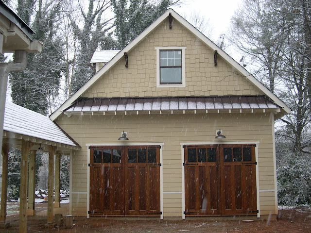

I really need to update the album with current pics. Since then we have put in a flagstone walkway in the breezeway, painted the posts, and graded the driveway.
The footprint for the whole slab is 30 x 30. The garage itself is just over 24 x 30. Downstairs ceilings are 12ft, roof is 11:12. The upstairs had 4ft kneewalls, 16ft between sides, and 8ft 6in clearance to the ceiling. Overall height is 26ft. If we hadn't built the breezeway we would have been limited to 16ft overall height.

Thanks for the compliments. That album is about a year behind right now. As soon as I find the download cable for the camera, I'll get caught up.
The plans are custom. My wife and I are friends with an architect who thought it sounded like a fun challenge. That idea is the one that won out from about five ideas he had. We gave him the basic parameters and let him go.

Who makes your garage doors? they really make the look. :thumbup:
thanks,
rob
The doors were by Evergreen Carriage Doors. Just search on that name and you'll find them. Really nice work, great service, and incredibly fast turnaround.
