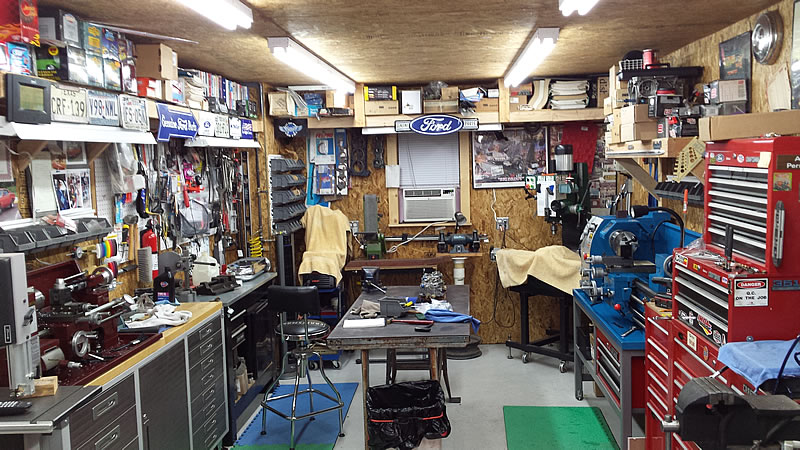

astroracer
Jun 22, 2005
3,001
Mid_Michigan
My machine shop is 8' x 24'. Two lathes and DP. The mill sets out in the working side as I didn't want to take it all apart to get it into the smaller room.
The best thing I did was put one of the lathes on a HF 44' roller cabinet.
The other lathe, along with my automotive wiring box, and a lot of project storage at the other end of the shop.
You will notice a lot of the cabinets on an casters... Best thing you can do.
Mark
Tons of storage for all of the machine tools and it keeps the stuff clean. Having the lathe moveable makes for easy cleanup.
