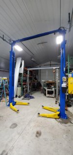

I went with standard white metal roofing panels. Trusses were 2ft on center and I attached the metal right to the base of them, used standard Jchannel all around the perimeter . Used 14in of rock wool for insulation on the back side no issues.

White 29ga panels here. 13'4" lengths to provide overlap. I paid approximately $2k for metal, screws and a manlift rental. It is 40'x50' with scissor trusses.

I think what you're looking for is corrugated galvalume. It's what I used on my ceiling, can't remember the gauge (maybe 28?) but it was pretty easy to handle. It comes in custom lengths, I got them somewhere around 14' each to cover my 40' ceiling with a bit of overlap. Anything longer would have been to long too handle. My wife and I put them up on a weekend, putting up the insulation and vapour barrier before the steel was probably harder than the steel itself.
I don't have any great after pictures, but these give you an idea. I don't notice any issues with noise or light reflection. Surface mounted electrical so there were no holes to cut, any trimming was done with a circular saw, blade reversed.
