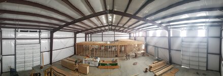

I built that exact home. I put home in middle and 50x60 on one side and 1200sq ft "atrium" (for county purposes) which will be my showroom about 30 x 40. I have 1735 sq ft living on bottom floor and engineered it to put second story if I want (lots of storage for now). I did 20 foot eaves. I used 6inch insulation on roof and 4 inches on sidewalls. I don't use minisplits until its 95 outside. Here's a panoramic when I was building. and installation of new age floor in showroom. I had to tell county that the 2 doors in the showroom are fixed so I wouldn't need a fire break between the two areas Like between the house and garage in pic 3.
Interesting. How long ago did you build this?
HUSTLESTUFF
Oct 7, 2005
83
Orland CA
Started Feb 2020. Dates are on Pics. Took me and GF building for 11 months to get final.
If you don't mind me asking, how much did that run you?
My fiancé, and I, are starting to considering doing a converted steeling building/barndominium so we can have exactly what we want. Compared to buying something prebuilt.
I've priced out the land, slab, building, but not really sure how to estimate everything for the living area.
HUSTLESTUFF
Oct 7, 2005
83
Orland CA
My slab and ground work was 50K, Building 66K with insulation and garage doors, Local company charged 25K to put up. So 141K for building. I installed garage doors. My lumber package was 17K 2x6x9 walls osb all the way around. TJI joist for second floor. We did a the work. Had a plumber friend help with that and hvac friend hook up mini splits but I installed the cassettes and ran lines. 15K for sprinkler system. All in all, I spent 215K. So $30/sqft for garage and atrium and $60/sqft living. I've added enough solar to heat and cool 50x60 garage with a couple mini split systems. That will be another 6K. Solar loan $340/month but cheaper than California energy and when I retire no mortgage and no energy bills. I went with high end appliances and built my own cabinets and island and top.
