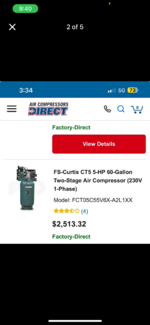

I have been watching the used compressor market for a while in my area. I found this compressor listed locally for sale on Facebook marketplace. https://www.facebook.com/share/GRfn28yPapnRzJ2k/?mibextid=79PoIi
The seller is a guy that sells estates. Owner is a guy that worked at our local college as the auto tech professor for 28 years after working for GM for 17 years.. He passed away and thus, the seller is selling the estate. I tell you this because it’s all I know about the guy. Based on the pictures, it seems like it’s in pretty good shape. He is asking $650 which is a great buy in my opinion for the specs. True 5 hp, 2 stage, single phase, 60 gallon tank.
What should I be looking for when I go to see it tomorrow? Looking at the site glass, oil looks pretty dirty, but it could just be the photo. I’ve been looking for a compressor that I can use for a blast cabinet (HF) and also to use air tools every once in a while and hvlp paint guns. Based on the cfm it should be great for my needs.
Obviously the price is very enticing and I did send him $100 Venmo to hold it. But I’m ok to walk if it’s not in good shape.
Anyways, thanks for your help and input. I appreciate it. (Pics are attached in case the Facebook post doesn’t link properly.)

I would not hesitate to take a chance on this. First, the pump alone (in running condition) is probably worth $650+. Worst case, you replace the tank for $700. This compressor, all in for under $1500, is a steal in my opinion. Second, you seem to know the guy and how he would take care of his things.
If it were me, I would open the tank drain and see what comes out. A little rusty or milky water is normal. Then, I would drop pressure to zero, close the tank valve, and time how long it took to fill from 0 to cutoff. Listen for any rod knocks. If the pump sounds fine and it fills in a reasonable amount of time, I think you're safe. From this thread post #13, I calculate about 7 minutes from 0 to 175 but somebody should double check me.
