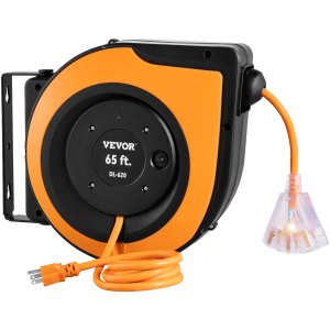

Anyone have any experience with these? 15 amp, 65 feet, UL listed.
Maybe I should have included a price range, cause some of the stuff you folks are posting, the prices are blowing my mind right now.

Bought mine a month ago, Works just fine so far. Used it to run a dewalt metal chop saw and works like a champ. I will note that I did trip the built-in breaker when I was pushing on some 3/16" tube wall with some real gusto.
Going to get another 1-2 for various locations in the future likely.
Do you have any issues with the reel not locking consistently? I mounted it hanging, and it take a few tries to get it to lock when pulling the cord out.
jcarapet
May 22, 2017
280
Texas
Not yet no. Just been listening for the clicky clicky, and it sticky sticky.
