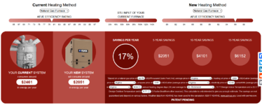

Goodman, Carrier, Trane, Lennox, and most other furnace manufacturers all make 80% AFUE furnaces. These use metal Type B double wall vents while 90+ furnaces use PVC intake and exhaust vents.
My furnace is installed in the garage in a location that would make running PVC pretty challenging. That and I'm in an area with pretty mild winters so the payback on a 96% AFUE furnace would probably be longer than the life of the furnace.
I'm not sure how accurate it is but the SEER Energy Saving Calculator site show the following heating cost comparison for 80% versus 96% AFUE:
