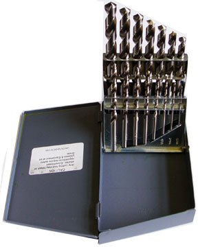

I would like to "buy once and cry once" when it comes to my next drill bit purchases. I would like a set that will last me a long time for woodworking and another set for drilling metal. I do car projects and sometimes you have to drill bolts.
What brands would I be looking at? I'd prefer something above "homeowner grade" but below "kidney to the Snap-On dealer" price. Any suggestions for quality (US or European made) brand bits that will work for my intended purposes?

Thank you guys for such a detailed and informative set of answers. I think I will go for the Norseman brand for my wood/non-ferrous metal drilling needs. I'm just a DIY kinda guy who does occasuonal woodworking and car projects. I have a drill press as well as handheld drills.
I'm looking at these sets. I'm assuming price varies due to the type of metal used in the "drills" (I've always referred to them as bits, so forgive the improper usage :p ). Any one of these look like a good deal? I'm leaning toward the 29 piece drill bit set for $69.
