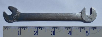

invest in some good pullers. 2-jaw, 3-jaw. no need to shell out a ton of money- check Ebay for used. ("Owatonna puller") (got three small 2-jaw models about a week ago for $16 incl. shipping)
also put "Posi-Lock" on your wish list. I have a model #104. works all the time, every time. not cheap. worth every cent.
don't go cheapo if you're going to get into 1/2" drive stuff - you'll just break fasteners and skin knuckles. you can find nice used stuff way cheap on Ebay, especially if you're looking for SAE because nobody's buying it.
get something to pinch off fuel lines. skinny-nose Vise-Grips with rubber hose on the jaws, or hose pinch pliers. something. way better than having gasoline running all over the place.
if you're working on older equipment, find some nice old SAE offset-head open-end wrenches - 3/8, 7/16, 1/2, 9/16 is probably all you'll need. aka: "obstruction wrench":
