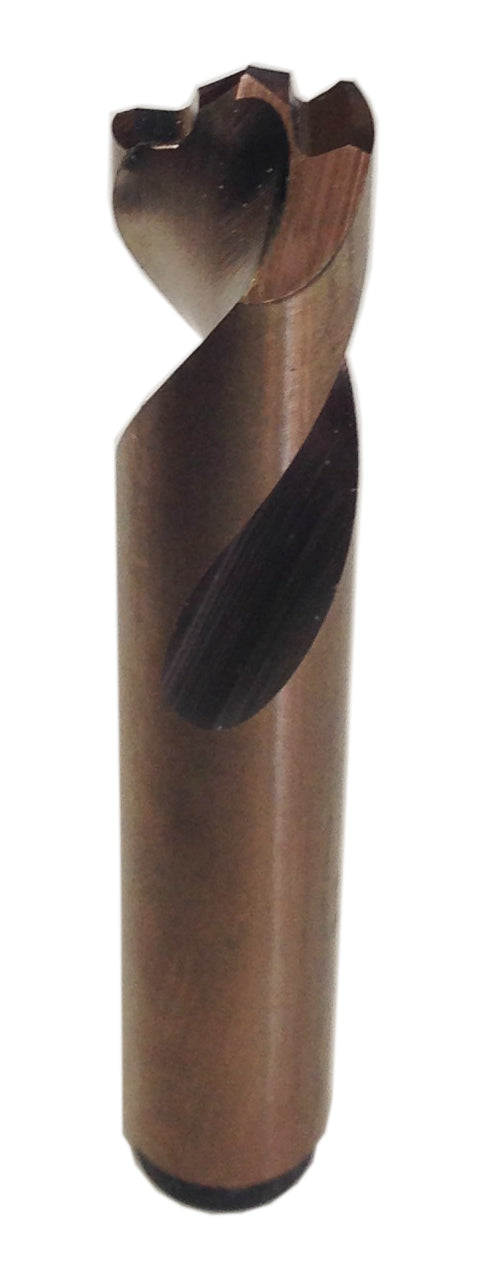

That's a spotweld bit. Not made for drilling thick metal, but that's how I use it. Short, hard, minimal flutes for evacuation. Don't try to cut with the flutes, it'll bind and snap. 8 and 10mm from norseman are my friends, they rip right though stuff. Same with Vortex point bits, amazing stuff. I had to drill out 4 studs last week holding a wheel on, 2 of which spun in the hub. Vortex point and tap magic ate them up. Norseman in general is my preference, although USA made stuff is typically good.
