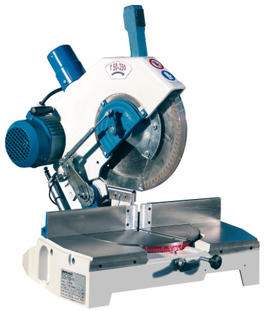

I have an Omga, it’s a brick *********. I set it up 3-4 years ago and use it daily. I randomly check square against my Starrett try squares and it always cuts perfectly. Daily use means sometimes hours of chopping at a time.
By comparison festool could not be relied upon for work requiring more accuracy than trim carpentry. It would always gap the square even after extensive setup.
Holy ****.
200+ lbs, 3hp and over $5k? Bet it's made you a lot of money.
With respect, belt drive saws like that don’t belong in this conversation. We’re talking Kia’s and VWs, and you are in Porsche Panamera territory.
My brother worked in a shop with a saw like that, made in Italy or Switzerland IIRC. The cut edge was finish ready. That’s a different beast.
I remember him saying, German and Japanese tools are the best up to a certain level. Past that are Italian and Swiss tools.
Knew a guy with all Felder machines. That’s all next level stuff. Really no comparison between that and the ww equipment normal people buy. I think he said his table saw was $20,000. I could have That wrong,

That is just for a simple miter saw, it can’t do bevels.
If you want a single bevel saw it $7800

I bought mine used and repaired a couple things. I lucked out and found an older model with a tilt head that is the largest they ever made. It’s about 250lbs

If there was a t50-350 localy for 1k I'd grab it.
If these were closer.. only $200 for a lower tier model.. and you can get two. Set up a left hand and right hand cutting station.
The little aluminum Omga’s are excellent machines, I ran one for a few years in my shop and it was accurate as the big one.
These aren’t made to service the requirements of a jobsite saw. They are made to chop aluminum or wood perfectly. The average user hooks it up to a digital or cnc outfeed table and makes the same cut all day everyday for the next 30 years without doing anything but sharpening the blade.
They are often fitted with air clamps and a self feed so the operate stands away and clicks a foot pedal.
Sometimes they are setup in a pair and set to a specific length and cut that length on repeat.
I can cut square to .001” over 8” with this saw, it’s a precision machine.
The shops that have these have different tools for cutting wide stuff or complex angles. If you need to cut wide, in those shops they might have a big sliding table saw.
Cut long parts or repeat lengths on the chip saw. Cut wide on the slider or on the panel saw.
If you have the work, this type of saw makes its investment back on a hurry. Probably the best ROI of any piece of equipment I’ve ever bought.
