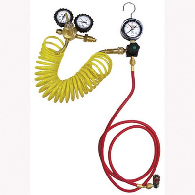

So what kind of set up do you suggest? Found this for $255,
Can I buy just a nitrogen regulator and connect it to my gauge set? Would need to get a tank with either one.

I'll probably get the micron gauge, but after watching this Scanner Danner video, (there is also a part 1 if you want see all of it)
I decided to start with nitrogen testing. Got this Uniweld regulator made in USA off Facebook for $50 and a filled 20 cf tank from a local supply house for $115.
What pressure should I test too? Like 150 psi? The low side never gets that high so I don't want to blow something there. Any idea how long a 20 cubic foot tank should last? How much volume is there in a system? Maybe less than 1/10th of a cf, multiplied by 10 times atmosphere = 1 cubic foot per test?

I put in 150 psi nitrogen. In half an hour it was at 100 psi. Found this leak at the upper condenser line. I assume it's a bad 0-ring?
Nice job, sir! Yep, probably a bad O-ring.
