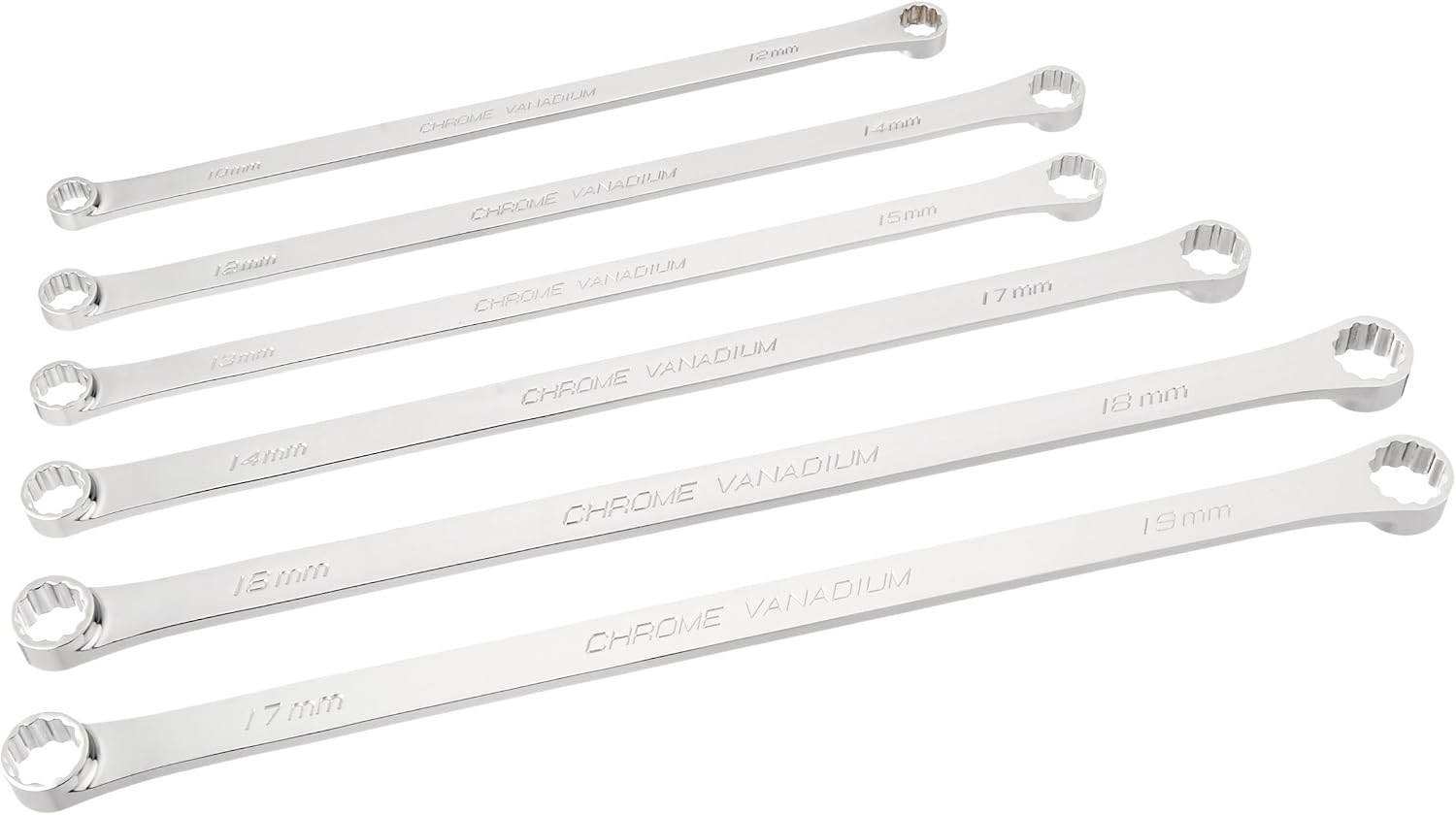

1/2" sockets tend to be on the bulky side and need more clearance, comparing with 1/4" or 3/8". For fasteners with easy access, I just use impact, especially bolts bigger than 19mm. Some fasteners on a car won't even allow any kind of ratchet/socket combo, such as brake caliper bracket bolts on a Honda. I found that I use long box wrench more, like these:
Break loose and back out with ratcheting wrenches.
