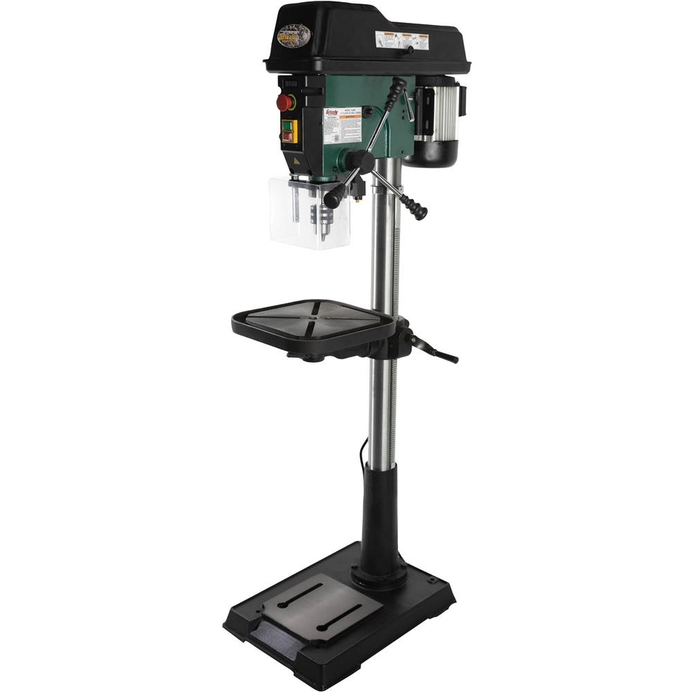

...... look at Grizzly, they just came out with a few new ones. This 17" vs looks interesting.
Wow this is great news.👆
DP have been in this weird phase where nothing low to mid market price was geared towards metal work. It's all mostly woodworking DP specs, w marked up pricing by names like Delta, Powermatic, and Jet. Grizzly didn't offer much either.
my top 3 suggestions:
Nova
that Grizzly 17" 👆
or start combing the Internet and local sales for vintage
