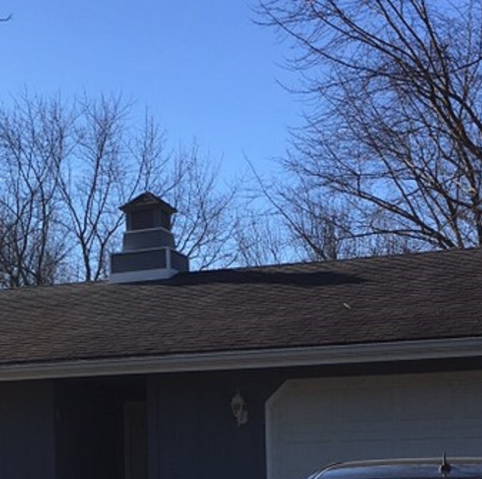

The county said any addition, a bedroom, a look out room, expanding the roof upward for more attic space would all work. They have seen people add a storage room above a garage before.
the variance is $1,000 and takes 4 months to process. She asked why I need the building so tall and an auto lift used for a racing hobby is a weak case against the board who will approve it. she said don't get your hopes up if you pay $1,000 and lose.
My contractor spoke directly to the inspector who will come to my area to do the inspecting. what he told me is straight from the inspectors mouth. it doesn't get anymore clear than that.

Okay here it is... All the answers I have been looking for. My contractor called me then right after the county building inspector called. Here's how the code applies my situation. Both had similar things to say.
In my county and township area a chimney is not even considered a part of the structure to measure by. Even though you may think it is a mechanical structure it is not. They are more referring to elevators for barns and things that have pulleys above the roof. random things like that. A cheap 24" by 24" cupola with louvered vents on it and those tin or copper roofs are more decorative and does not count. Now if you build a cupola along the lines of something bigger and it has a shingled roof matching the house it is now part of your structure. They recommended a "look out room" above my existing garage. Maybe 3ft tall walls and a 4/12 pitch shingled roof to match the house. match the siding on it to the house. put some windows in. maybe something that is 4-5 feet wide. it does not have to be accessible or functional as a room but it needs to be part of the house. So what I gather is it needs siding, a shingled roof and possible windows and it is part of the house. So I may build a 48" x 48" x 36" tall box out of plywood and side it with my siding to match then put a window in the front and build a roof on top of it a the same pitch as my house and shingle it with the left over shingles I have in my garage. it would be about 5 feet tall overall and would do the trick. I feel this is my only option.
Build it, but just on top of your shingles. Then toss it when you are done...

I would want to have spoken directly to the person .. or had my architect.
They don't allow a copula .. but, will allow a 4' one? Is there a square foot limit ? So what do they do? come out and measure once you are done .. and then approve your plans. Do you have plans?

Update: The cupola showed up and I took some measurements. I needed about 6" taller to be equal to the height of the new building. I decided to make a base for it to cut the roof pitch into. It is now over 6" taller than the new building will be so there are zero issues if they measure. Just finished putting the shingles on that match my existing roof and painting it the color of my siding. The contractor and building inspector agree there is zero issues. This thing is pretty big and it has actual shingles on the roof. This is 100% part of the structure once bolted down and THE highest point of the roof by code. Once my tax return comes I will drop off the down payment money and the permits will be pulled. Shooting for april 1st pouring concrete. I'll make a post once construction starts on the build.
I have it sitting stacked up in a mock up to see how it stands. it is in 4 pieces so its easy to carry on the roof before screwing together.
So total I have $425 with the cupola, building the base and shingles. $425 to save me $11,000-$13,000 is well worth it. As others have said If I don't like the look of it, in a year or 2 I will rip this thing off my roof. it wont matter at that point.

Update: Filed for a building permit Monday. Submitted the plans and everything was approved they just have to send a guy out to verify the well and septic is a safe distance from the building site like I said it was. We should be good to go by Monday. Only issue holding us back is they just posted the roads for temporary weight limits for spring on March 7th. This will last 4 weeks on average so we cant get dump trucks or concrete in here until atleast April 4th. possibly few weeks after that.
Here's the Coupla mounted up on the roof.

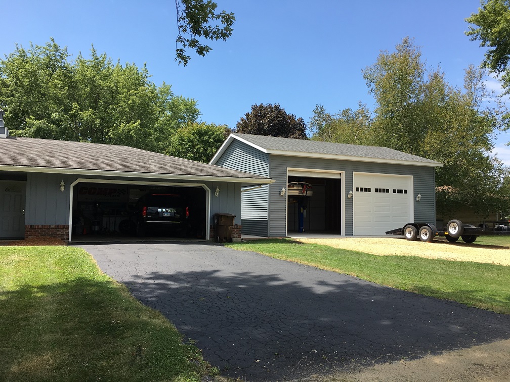

Another update... The building is now complete. I have electric and natural gas ran out there and a 2 post lift installed and have been working out of it for a few weeks. It passed all inspections with flying colors. It's a big weight lifted off my shoulders that everything got approved and was passed. This was a long process but I can finally enjoy my new garage.
You can see the part of the cupola on the left side of the roof, it ended up all said and done about 2" taller than the peak on the garage. My contractor got up there with a laser or something and said its damn close. We got lucky. lol
