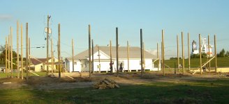

I finally have something to post. This is a Rob-Bilt building and crew. I am located right on the Mississippi River about midway between New Orleans and Baton Rouge. The crew showed up around 10:30 this morning and the lumber about an hour later.

End of day 1 1/2. Note the bookshelf girts which I learned about right here. This six man crew is awesome.

Man, you're not kidding about being right on the Mississippi; I see a ship passing in the background!
Impressive build... keep the pictures coming!

Concrete is next. I agreed on a price with the finisher this morning. He will start this week and we will pour somewhere around the 6th of November. $1600 worth of steel will be delivered Monday. Two 1/2 rebar around the edges and highway mesh everywhere else. Probably overkill but you only get one chance to do it right.
After the concrete is done I wll order the doors. They will be Amarr insulated commerical jobs $$$$$.
Then spray foam the roof, white metal ceiling, fiberglass in the walls. cover the walls, electrical, plumbing, etc. I'm tired already and getting poorer every day:)

wow that flew up....great build, would love a shed that size some day....
can i ask a question about the poles please......why are they not protected going into the ground??? will the timber not rot with mositure????

Been out of town all week but some progress was made. The plumbing is down and approved. The slab prep will finish Monday. Should pour Wednesday.
Coming along quickly for such a large building. :thumbup:
can i ask a question about the poles please......why are they not protected going into the ground??? will the timber not rot with moisture????
I'm wondering the same thing (seen this before, but still don't know why they do this). Under the impression that it would rot faster this way as well, particularly with the newer formulation of treated lumber. :dunno:

The polls directly in the ground seems to be pretty common, but makes me uncomfortable as well. I assume its a cost thing, cheapest possible way to get the polls installed. I would think a footer and then metal bracket to mount the polls to would be better, or something similar...

Most pole builders use "lifetime guaranteed" pressure treated wood. I have seen some old posts come out of the ground looking as solid as the day they were put down 20-30 + years ago. Some post building contractors use plates and brackets on top of the footer/slab. Every builder has their preferred way and supporting argument.

These are ground contact treated poles. My dads old barns are 50* years old and were built without treated lumber and are still there. This soil is very sandy and drains well.
