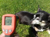

I have the harbor freight model. I bought it to check exhaust temps to see if my catalytic converter was plugged. It did the job. I use it pretty regularly for non-critical stuff. You know, like checking the temperature of a sunbathing black dog:
