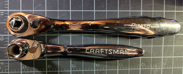

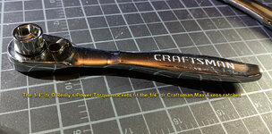

Just going off this thread, I decided to pick up O'Reilly's 1/4" dr pass-thru ratchet and socket set while I was passing by one today. I gotta say I'm surprised by just how much lower clearance they are than my Craftsman Max Axess 1/4 dr pass-thrus.
The ratchet is pretty underwhelming though. It has a LOT more backdrag than my Craftsman does, so much so it's safe to say it has more backdrag than any other ratchet I own and probably more than any functioning ratchet I've ever held. Perhaps a soak in some lube will make a difference. The good news though is the Power Torque sockets fit my Craftsman Max Axess ratchet. I wasn't expecting that.

Suh...suh...six-point??????
(Thanks for the always-great pics, btw.)

I haven’t tried the ratchet they sell to go with it, that’s good to know. For mine I just use a few different 7/16” ratcheting wrenches: reversible, flex, stubby

No they only sell metric sockets unfortunately.
