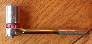

RE: position of detent ball on drive anvil:
Excellent point, but I have to wonder:
Is this not more a function of the design of the socket? (the position of the detent in the drive end of the socket will determine how far the socket is going to slide onto the drive anvil, correct?)
Then there's the question of:
Does the drive end of the socket seat all the way down - "flush" with the drive side surface of the ratchet?
or
Is there some sort of "shoulder" at the bottom end of the drive anvil that puts a bit of distance between the drive surface of the ratchet and the drive end of the socket, as is seen on some newly-introduced drive adapters. (see below)
(Second question is purely speculative because I simply do not know how all these newer designs are built.)
This will be an interesting rabbit hole for somebody brave enough to dive into it. ;)

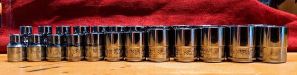

LoL - In retrospect, I'm going to drop 8mm. I don't work on Ford at all (vintage BMW, Mini, Volvo, Honda and Mazda in the family fleet, plus my mom's Toyota), but mainly I'm just trying to show a range because the differences can change. For example, look at the pic of the Tekton vs. Icon 3/8" sets below (I've posted this pic a number of times here on GJ), the difference really starts getting dramatic around 14mm:
(I'm realizing I'm hijacking the original thread, so I'll end this line of discussion here out of respect for the OP and members)
28,953
M635_Guy said:
"...hijacking the original thread..."
For the purposes of accomplishing what you're hoping to accomplish, you're going to be posting all kinds of crazy stuff. Trust me on this one. Don' worry about. It's part of the learning curve. ;)
(Sometimes I see stuff I've posted when I was trying to sort out some patent on something and just walk away shaking my head wondering "What was I thinking?")
Yes, the overall height of the sockets is going to be a determining factor, and I have noticed wild variances in socket height on the same size socket made by the same manufacturer. (Thorsen, Indestro, others.)
That Tekton is so widely popular, yet seems to make one of the tallest 1/4" drive sockets in the industry is truly a puzzler, is it not? :headscrat

I couldn't find one from a manufacture that was between 30 mm and 38 mm. But Tekton 3/8 mini extension and snap on low profile 14 mm 3/8 (smallest one known to exist) would pit me at 34 mm about
Thank you for the recommendation. Can you measure the thickness of the head?
The Mac/proto super Short sockets are pretty much exactly the same depth as the snap on low profile when you're using them on a normal ratchet. Just letting you know all the available options in case you can find a better deal. Plus the Mac/proto super shorts actually utilize the detent on a normal ratchet so they stay on better, whereas the detents on the snap-on low-pros only work with their low-pro ratchet

I'm looking for a low profile 1/2 drive ratchet. Can someone please recommend one and include the thickness of the head (not including the square anvil)? So far I've seen
Tekton SRH22214, .7 inch (17.78 mm) thick head
Capri Tools 12500C, .69 inch (17.526 mm) thick head
I see a lot of ratchets that claim to be low profile but very few that specify the thickness of the head (not the width). Meaning from the back of the ratchet head that is flat, to the other flat portion on the front of the ratchet that is on the same side as the square anvil. So I'm hoping people on hear can post the lowest Profile Ratchet that they have in 1/2, and include the thickness of the head (not including the thickness of the square anvil).
My current 1/2 ratchet is to thick in the head to remove a fastener on the front of my engine. Need 1/2. 3/8 sockets I have are not long enough. Need a 14 mm 6 point that is between 38 mm and 30 mm. My 30 mm in length 14 mm socket is 3/8 drive and can't get ratchet on it behind the pulley. My 38 mm long 14 mm socket is 1/2 drive and appears to be good length but my current ratchet is to thick at about 24 mm. My 1/2 braker bar is even thicker.
My current 1/2 is some no name brand Chinese made I got off Amazon.
Thanks!
