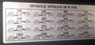

Just look for one with 3 pulleys up top that uses 2 belts like this pic:
Here is the speed chart for the different belt configurations:
I waited and waited for a good deal on a Canadian or US made DP but finally pulled the trigger on a 10 year old Taiwan 17" 1HP MT3 like new for $290 and it came with a full drill carousel, mobile base, cheap cross slide vise, T-slot table etc. I'm happy with it as it does what I need.

Recommended speed for a 1-inch bi-metal hole saw is 350 rpm in mild steel. That should not be an issue for most any large drill press, even 2 pulley models. Another option would be to install a 1140rpm motor on a standard press to lower speeds substantially.
