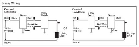

Will a low voltage dimmer for flat panel led lights work with a 3 way switch?
Obviously one would only be able to dim from one switch, but besides that?

It should.
Git response above is not correct.
Wire the 0-10VDC dimming wires - violet & gray - direct to a 0-10VDC dimming only control (like this one). This is a completely independent circuit from your On/Off AC line voltage leads. Wire regular On/Off switch function any way you like. You can only use 1 dimmer per fixture. You can wire all fixtures to 1 dimmer.

I missed the "low voltage" part, sorry - disregard my previous post
