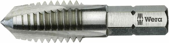

I'm looking for shallow tap sockets for tight access - I've got something similar to the Lisle ones, but they're longer than I'd like. I haven't had any luck finding what I'm looking for - any suggestion?
Alternatively, short length taps for thread chasing would work...but I haven't found those either.
Thanks for any wisdom!

Wera makes 1/4 hex metric tap bits.
Those are pretty neat. 7 piece set isn't too expensive either but it doesn't say what threat pitch they are. I only found one set for metric. But you can never have too many tools in your oh **** drawer for when things go south. Can be the difference between a small hiccup and a horrible day when you break a bolt or threads get messed up. Thanks for sharing another tool I didn't know existed. My luck is they won't be the right pitch but worth having if they work once to save the day.
Where did you find them?....agreed, they look interesting and useful for stressful situatuons!

Thanks for all the suggestions - the Wera bits that KnurledNut suggested seem like they'd work quite well. Going to order those.
Those will be metric coarse pitch (which is roughly equivalent to most other fine pitches). These are the threads you find mostly on vehicles, general hardware, etc
M3 x .5, M4 x .7, M5 x .8, M6 x 1, M8 x1.25, M10 x 1.5
Metric fine is very fine and only used for relatively specialised applications. The only common one on vehicles are the wheel bolts.
But yes, they should have specified!

When I contribute to a thread like this, I’m attempting to be helpful to the O.P, who obviously has a particular problem to solve, and in this case answer a particular question about the tap bits that KnurledNut helpfully posted.
I could, just give a simple answer and say “they will be metric coarse”, however, I try and think through things a stage further. I assume the O.P. is in the U.S. so he’s probably used to looking at things like Unified threads and thread chasers, and is perhaps less used to looking at metric ones.
He may be thinking “I don’t want coarse thread, I need standard” or “they look like fine pitch”, so I felt a bit more explanation was fair, hence I stated that “metric coarse pitch is roughly equivalent to most other fine pitches” - which it is, and that they are MOSTLY (not exclusively) used on vehicles, which they are.
To continue, I stated “metric fine is very fine“ which it is, compared to say Unified fine, and only used for “relatively specialised“ applications, which I would argue it is. Wheel bolts are one such application. O.K. you’ve got some on your engine, but… the coarse pitch‘s are still, generally, the more common.
To be pedantic, the number of fine pitches available as standard varies with the thread size. In M4 for example, the standard / coarse pitch is .7, the fine .5. In M14, the standard / coarse pitch is 2, but fine pitches generally available are 1.5, 1.25 and 1.0.
In the case of these tap bits, they go down to 3mm and I would suggest that there is only one fine pitch regularly found in those small sizes.
For what it’s worth, I keep some basic metric taps and die nuts in my general box for dealing with threads on vehicles. The only metric fine I have are 10, 12 and 14 and those are all I’ve needed for vehicles, but everybody has different needs.
To get back on topic, yes, those tap bits look useful. Used in a bit ratchet they will be as low profile as anything, and a set would be a great thing to add to a road box.
My only concern with those particular ones is that I believe they are made in China, and I’ve never found a Chinese tap that was up to much.

@Dave455
Check out Voelkel's offerings before pulling the trigger on the Wera.
They have quite an extensive range.
https://voelkel.com/en/
Catalog starting page 60: https://voelkel.com/media/4e/69/b8/1709295983/VD 23 DE-EN.pdf
The DS series is very unique.
I was aware of the Volkel, but only the regular length - not the short ones, hence I didn’t mention them.
Yes, I think they would be far better quality. I’ve got a few Volkel taps (I think Volkel and Lyndon are all manufactured in the same place) and they’re fine. Not top end perhaps, but decent hand taps.
Even if they are not quite as low profile as the Wera I’d take them in preference!
