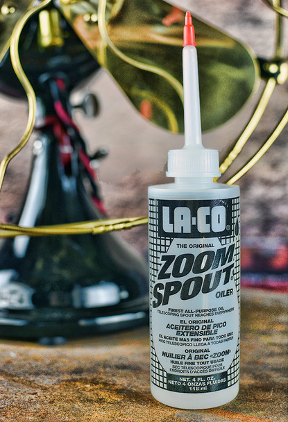

Clean bearings and new wicking is the most important factor.
Your motor is similar to what was used in old fans. The antique fan guys have always preferred a 20 wt non detergent synthetic oil for these old oil cup style motors. (or ISO 68)
I wouldn't overthink this for a low duty cycle motor. Just use 3 in 1 for Motors or Supco Zoom Spout Turbine Oil.
If you want to get fancy then seek out Royal Purple Synfilm ISO 68 or Amsoil 20 wt compressor oil. Just don't go lighter then 20 wt. viscosity.

Ah, thanks you for the link and the image of the can!

Yep - oily oil is what you need, lol. These bearings are very tolerant, I wouldn't over-think it. Clean it up, get new wicks and put some oil in it.
3-in-1 was the only oil we had in the house when I was growing up - until we got a fancy new forced air furnace in 1960 that had TWO blower motors (on one blower - early 2-stage furnace). From an early age (8 or 9), it became my responsibility to change the filters and oil the motors twice a year after watching him do it several times. IIRC he bought a can of 10W straight-weight motor oil. Since we only needed a little bit we didn't use a spout - he showed me how to use an awl to puncture the can and then how to wet a piece of paper with the oil to "seal" the can back up. Also how to make a funnel out of paper to guide the oil (mostly) into the oil cups. The motors worked well for ages beyond that - and they were whisper quiet.
Fast forward a few decades and I can't tell you how delighted I was to learn of the zoom-spout product!
