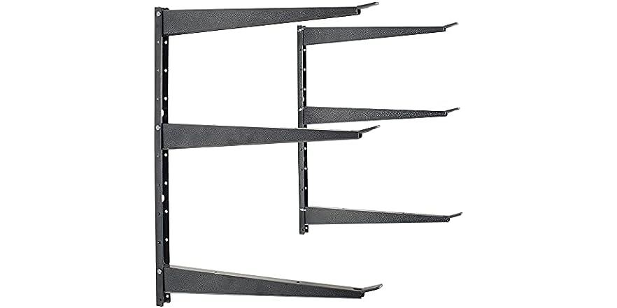

I don't want vertical, I want horizontal.
I suppose something like this is what you are referring to. Not sure I would want that attached to my siding but maybe it wouldn't be any worse than a metal structure.
Another thought is drilling into the 4x4 fence posts and using them but might cause accelerated end of life for the fence.

That's very similar to what I did. I used 2x4s and 3/4" galvanized conduit. It's cheap, rock solid, and infinitely customizable to fit your needs and space. When drilling the holes for the conduit I tilted my drill press table about 10° so they angle up slightly.

Built the same style, screwed to the wall with countersunk GRK construction screws into the wall studs. It holds what I put on it. EMT tubing cut to length with a plumber's pipe cutter, plastic caps readily available and it is cheap to build. I find it works better with at least some 'shelves' of plywood rips, since I always seem to have short stuff I'm trying to get up off the floor...
I did s set outside mounted to the back of my woodshed to get my drainage pipe collection up off the ground and out of the way,
