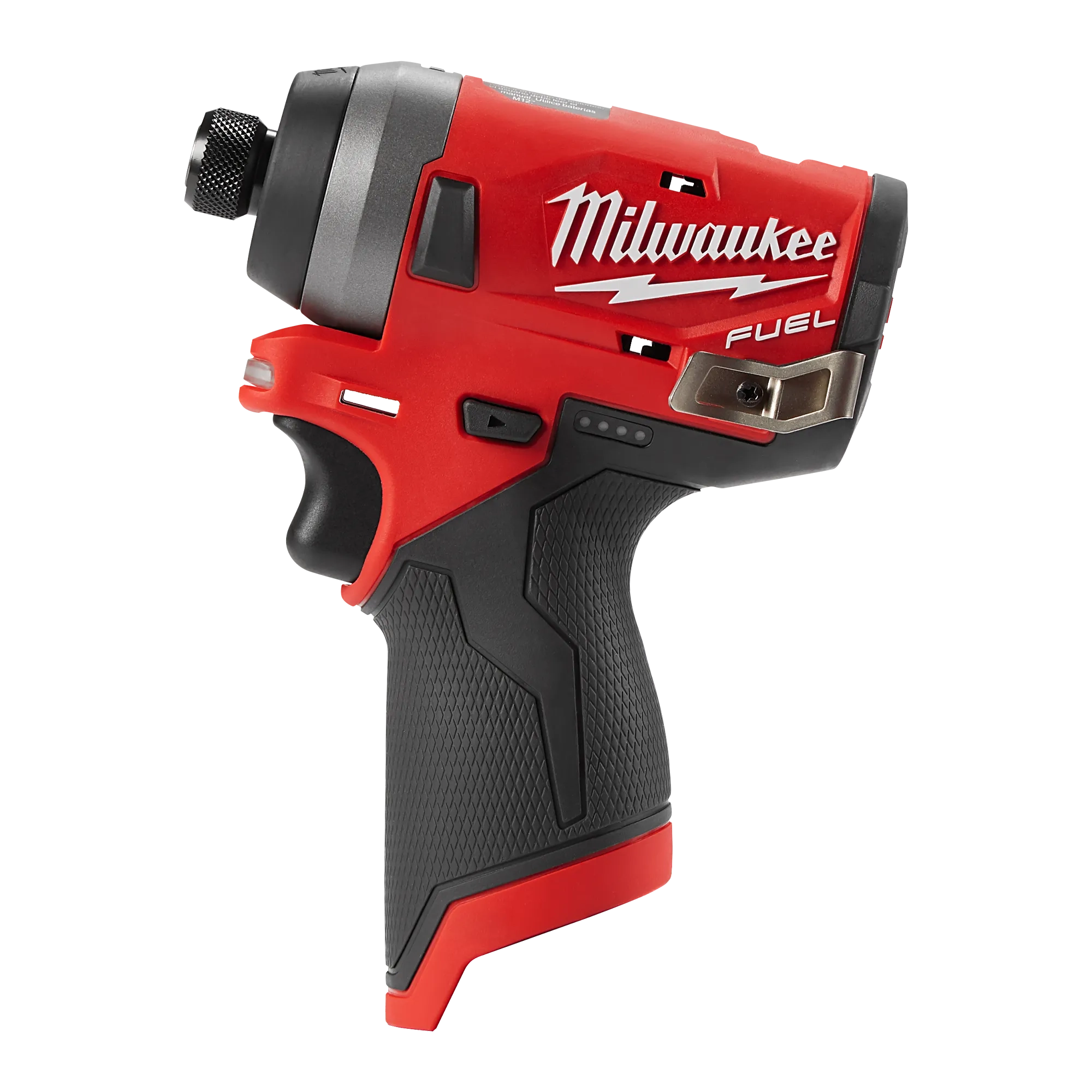

i have the 1/4 hex driver, would the 3/8 be more powerful enough to justify buying? links to both products below
if i get the 3/8 it would be replacing a ridgid 18v hex driver, how would the 3/8 impact stack up against the ridgid 18v?

I have the 1/4" Impact driver, and while I like it, I consider it a fairly "light duty" type of tool. Basically Milwaukee claims it puts out more or less 108 ft. lbs. of torque, but I haven't pushed mine anywhere near that hard to find out if it's true.
A couple of days ago Acme Tool had the 3/8" Stubby marked down to $129 so I hopped on one of those to see if I like it. My hope is that I can use it for taking off lug nuts occasionally, so I don't have to break out my 1/2" mid torque except for heavy duty stuff. BTW, I'm a weekend wrencher only if that matters.

Totally different tools. The 3/8" or 1/2" stubby impacts are worth the buy-in for the M12 line. IIRC, only the anvil is different between these guns. I have the 1/2", and it's my go to.

I have the 3/8" stubby impact and it is a hard hitting little powerhouse. I've never put it to a bolt it hasn't removed. I have taken suspensions apart with it and it didn't need full power. Obviously I haven't asked anything of it that it wasn't designed for but I haven't even used my big daddy Makita since I bought it. Two thumbs up.

I have the 2454 M12 Fuel 3/8" impact along with a 3/8" square to 1/4" Shockwave Impact Hex Adapter. Great combination ! The 3/8" square drive is perfect for working on outdoor power equipment and some brake work. In a pinch you could just A 1/4" socket but the adapter has the locking quick change mechanism which is very nice.

What do you want to use it for? They are very different tools

1/4” hex impact for me drives screws into wood.
3/8” impact wrench does 10-19mm bolts in automotive applications.
Although they may look and work similar, using a 1/4” hex impact to do lugnuts and a 3/8“ impact wrench to drive screws into wood leads to unnecessary frustration.

If you're already covering 8mm-19mm with the 3/8" stubby, why would you need a different tool with a 1/4" anvil to cover 8-12mm fasteners? Especially when the stubby impact has 3 torque settings you can dial it down with if you're worried about hitting too hard on something tiny.
Like others have said, the 1/4" hex drivers have their use, but it's not really meant to overlap with the 3/8" stubby.
I've got the M12 3/8" stubby, the M12 Fuel Surge, and the M12 screwdriver, and I use all 3 of them a lot, and they all do what they're supposed to do well. Surge is great with deck screws, lag bolts, anything going into wood, and I replaced an older DeWalt 20v 1/4" hex driver with it. Much quieter and has just as much power. The screwdriver has lots of clutch settings so I can use it to assemble or disassemble even delicate screws, Ikea furniture, stuff like that without stripping it.

If you expect to use it as a light impact gun, you do not want the Surge. If you want smooth woodscrew use, go Surge.
The 1/4 hex tooling available is expansive. For that reason, getting the hex driver is probably going to make a more versatile tool than getting the stubby 1/4 square.
