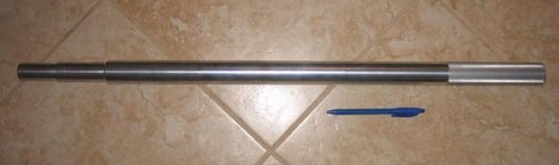

This is an alignment tool to align the gimble bearing and motor on a mercruiser equipped boat. Chucked a piece of 1 3/8" in the lathe and turned down the business end. Flipped it over and put some knurling on the handle and tada, the tool is ready. It's a bout 2.5 feet long.
Making tools is almost as fun as using them.

You can see the knurling tool in the lower left of the 2nd to last picture. Basically it's two wheels with angles lines on each wheel. When they're pressed into the the work they displace material in the diamond pattern. There's all sorts of different pattern wheels available.

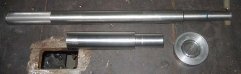

Some more boating tools. Aluminum was a poor choise to make the gimble alignment tool from. I recut one from Stainless. Much beefier. Tool on the bottom of the first pic is of the u-joint bellows ring installer. Handle is stainless, driver is D2 tool steel (was laying in the scrap pile).
Next, the tool to remove the drive shaft retaining nut, which holds the driveshaft/bearing assembly in the outdrive.

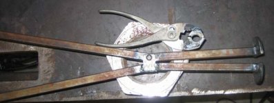

lastly, the tool to crimp the shift link bellows crimp. A nut welded to an old pair of pliers, then cut. Bottow of pic is the tool to expand the exhaust bellows to get it on the bellhousing. Made from some scrap steel 1/2 tubing.
It's almost as fun to make tools as it is to use them.
