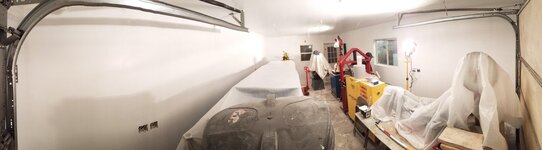

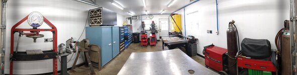

Welcome to Made By Miller Studios, my 14'x24' detached garage turned workshop (established October of 2018) as well as my home office design space. This is the home of my company, Made By Miller (@madebymiller_ on Instagram). It started off extremely basic and bare bones, and it's steadily evolved over time in my quest to maximize my space and convert it to the laboratory like shop of my dreams. There is a lot to detail in this thread, but I'll start this first post off with before/current state shots.
This shot was taken 8/30/18, less than a month before my first child was born (super pregnant wife). We were just looking at the property for the first time before we purchased it and moved in about a month later.
Here is the current state of the shop as of 6/22/23.
In this thread you'll find a broad mix of my passions and interests, from welding and fabrication to CAD design, 3D rendering, 3D printing, amateur photography, and some of the projects I get myself into around our property.
Thanks for stopping by!

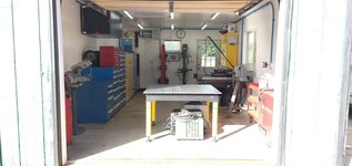

More changes - some things added and even a few subtracted. I sold a few of the Vidmars that didn't really suit my needs and I found another great deal on a Vidmar cabinet more useful to me on Facebook. All of these cabinets came out of the local Air Force base at some point, I like to joke that I'm just reassembling the group in my little shop.
With those changes, here's how the shop looked (6/16/19):
My wonderful wife bought me the perfect shop clock after I had been searching for a while for one that plugs in. It has a glass face and steel housing. Very heavy and quality made clock.
A friend of mine gave me some really heavy wall hanging cabinets that came out of a hospital for practically nothing.
I cleaned them up and got them hung. This was the state of the shop as of 7/15/19:

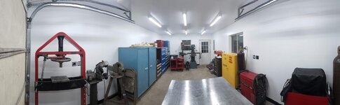

The state of the shop as of 11/8/19:
I immediately got back to work on customer jobs. Check out the big new additions, the Industrial Maid air scrubber which filters all of the welding fumes out of my shop air, and my new propane heater with wifi thermostat! No more freezing in long johns and coveralls for 15 hours a day! It was so refreshing to work in this space now, BEST PLACE EVER!20191112_184612.jpg20191112_184629.jpg

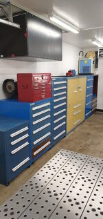

It was time again for another new piece of equipment in the shop. I ordered a brand new shiny fabrication table from Stronghand tools. I always research and deliberate laboriously over any new tool, and after weighing all the different table options out there, I was confident that the modularity and flexibility of the BuildPro tables would fit right in at my shop - so I ordered a 4'x4' Max along with some tooling. It was love at first sight! This table is such a joy to use.
Here are a couple of the first projects off the new table, a dummy bomb kit my friend Joel (@overkillracingandchassis on Instagram) sent me, and an awesome 3D printed dead blow hammer kit that my friend Dave (@davemoneysign on Instagram) sent me. I added my logo to the dummy bomb, and after TIG welding the handle to the head tube of the hammer I torch blued and lacquered it.IMG_20210307_174957788_HDR.jpg
You may have noticed the yellow doors and drawers are new in the blue cabinet in the back - good eye! I scored yet another big Vidmar cabinet, and decided that the drawer setup is more useful in my shop than the full doors. Thankfully the cabinets are fully modular, so I was able to just swap the doors and drawers out without having to move the big heavy cabinet body. The blue doors are now outside on the yellow cabinet keeping firewood dry.

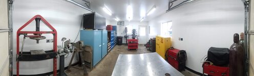

Most recently (7/15/21) I got to a couple long overdue shop projects: mounting the air scrubber to the ceiling and getting the Vidmar cabinets off the 2x4's and bolted together. I also used this opportunity to reorder the cabinets in a way that makes a bit more sense as far as location in the shop. This was a lot of work and required completely pulling all 32 drawers out of the cabinets to make them light enough to lift off of the blocks and maneuver for fastening together. That being said, I'm thrilled with the results.IMG_20210715_174658708.jpg
I used some unistrut to mount the air scrubber to the ceiling, fastened to four rafters. It worked very well and I'm pleased with how tight I was able to get it to the ceiling. At the same time, I also attached some cable channel to the ceiling to plug the cord (cut to length with 90* plug added) in to the ceiling outlet I added for this reason when I renovated the shop.
And the current state of the shop as of today 7/17/21:
You might notice that the mill is gone, I sold it to buy a new piece of equipment...

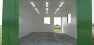

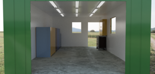

To wrap up the posting for today, I thought I would share some of my 3D CAD model renderings I made in Fusion 360 of the shop and some of the equipment. It is so useful to have this virtually when it comes to shop layout and planning for new equipment. I still need to add a few key pieces, such as the plasma table and welders and shop press. Stronghand is generous enough to provide models of their tables, so that saved me some time in modeling. Things like the drill press and belt sanders I was able to download something similar from GrabCad and modify to make more accurate to reality.
In the following renders you can see the new piece of equipment that I mentioned in the last post mocked up where I thought I might place it - a Shapeoko Pro XL cnc router.
