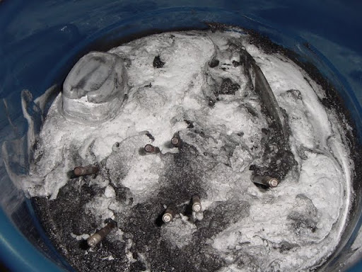

I did not watch the video, on phone. For fun you can run a bead on mag with alum wire and break the bead off and vica versa.
First test that it is mag, white vinegar with fuzz indicating it is mag, it also etchs it so it does clean it. In regard to porosity, castings has it the most. What I have done that works out is pulsing, with the foot not a controller. Just enough heat to make the puddle alittle bigger then get off it and repeat as needed. Oh when done let it cool then smack it to make you didnot use the wrong filler.
VWandDodge
May 20, 2011
951
Here's what happens when magnesium is bathed in vinegar.
http://www.thesamba.com/vw/forum/viewtopic.php?t=442291
