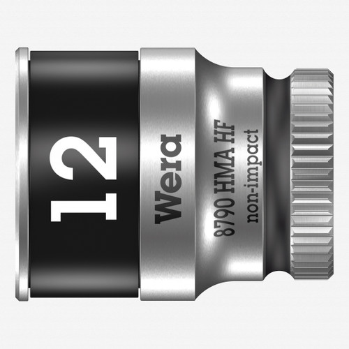

Wera offers Nut holding sockets similar to Ko-Ken's.
