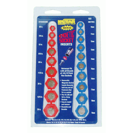

I've seen some thin magnetic inserts for regular sockets did at the local Sears a while ago.
Their tool section looks like a ghost town these days, so doubt they still offer them.
I think I picket them up several years ago, they looked like this:
They don't work very well. I've used them a few times when working under a car, and they do function, but are pretty clumsy.
