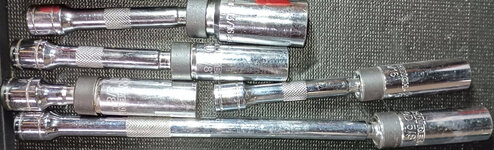

Okay I'm really late to the party and wish I had these back in the day of 30,000 mile plugs. I've had the Vim set for about a year and finally used it yesterday changing spark plugs on a 2019 silverado, including the dreaded number 8. I wish I would have had these years ago. Can't believe how smooth the job went. I used the one that has the magnet in it and a universal joint. The joint is not floppy and not too firm, and I used it with a wobble extension and it made the number eight a breeze. I did take out the fender liner which took all three minutes, but I can't get over how nice things work not having to mess around with that little rubber insert and have it stick on the plug half the time or making it a pain in the *** to get on it and index it in the first place. Usually I'm just changing plugs in my old dump trucks, this is the first pickup I've kept in a lot of years to need plugs changed or that wasn't a diesel. I can't say enough good things about that socket.

I've always used a piece of rubber hose pushed on to the top of the plug. It allows me to feel the threads by hand. Then I put a socket on it. I also have a Chevy 1500 with V8.
I've done that trick lots of times myself, I was really surprised how much feeling that I could get with this socket and the joint that has I'm assuming O-rings or something in it to make it a little tighter.
