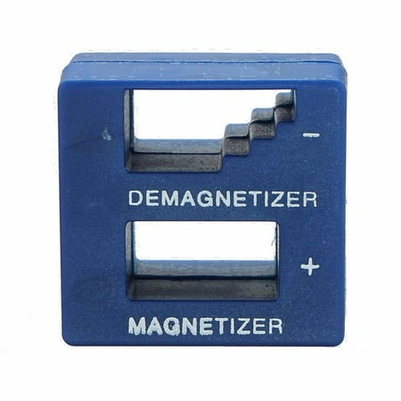

As an electronics tech, there is nobody in the shop that does not magnetize their screw drivers.
We've also got one of these magnetizers which make it easy (I just scrub a magnet across them at home);
