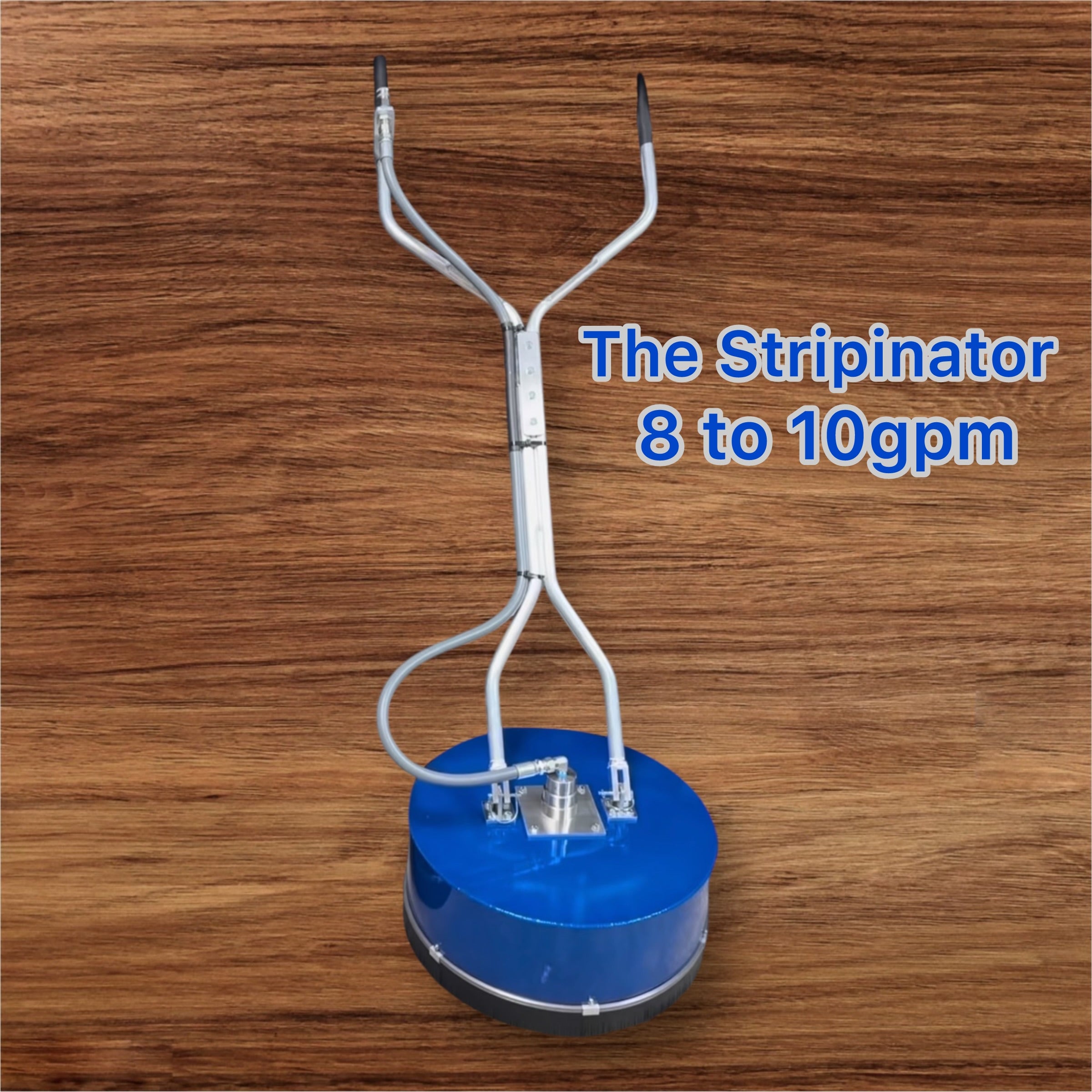

Check this out. Trying to talk my brother into getting one since he's starting to get into paver work. His first paver clean, sand and seal job was a monster. That was first coat going on.

That stripinator is a hard pill to swallow and store for personal use at 2600 bucks. I do just under 3000sq ft and 500LF of fence in two half days. Wash the first day sand the next. I could do it in a day but I don't want to. Turbo nozzle for 29 bucks please. I hope you brother buys it and lets you use it as that is a home run.

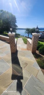

Sealing will help prevent stains from soaking in. My brother said he charged right at $2.50/sq ft. Today we had to do the bluestone on the back of that same house.
