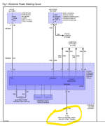

Always keep a winter time, salty daily driver here, to keep the Silverado inside. Currently running a 2008 Cobalt. I put in an aftermarket radio 7 years ago, no issues. Just happened to notice some whining and humming on both AM and FM, of course much more defined while on AM.. Only happens when I touch/grab the steering wheel. Just a fingertip touching the steering wheel causes static. These Cobalt's have an electric power steering system, no fluid. Guessing ground somewhere? Cobble up a new ground for the steering column maybe?

I would check the ground on the radio as well.
How many times have you touched the old TV antenna and you'd get a better picture ? You're acting like another ground and not realizing it.

The PS motor is grounded through the PS control module, that ground comes from G109 located under the hood on the left strut tower.
