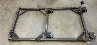

I made a mobile base for my Craftsman Floor Model table saw 103.27270. Used parts from some preexisting bases around the shop that I was no longer using. Adds hardly anything to the overall height, about an 1”. The table saw sits in right square of the picture below and the legs for the router table extension wing sit in the left square in the picture below.

Pretty much any rolling base made for a cabinet or contractor saw will work. They tend to keep the bottom of the saw close to the floor by offsetting the wheels a bit higher up.
