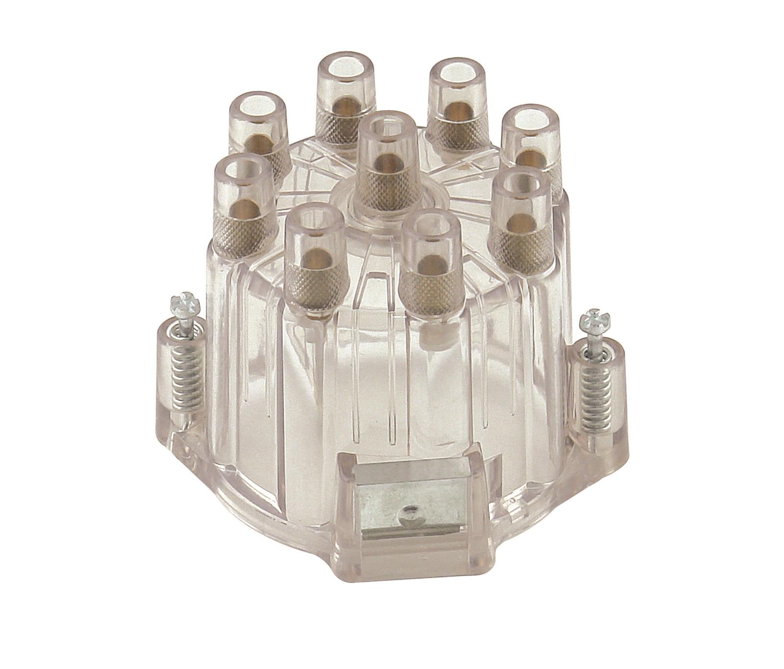

Transparent distributor caps were available as aftermarket accessories *many* years ago, ostensibly for fault-finding around spark.
Here's an ad for the Remax Klearcap from the Earl's Court Motor Show edition of The Autocar in October 1954.
I have yet to find one of these for my old Triumph TR3, but I'd like to try it.
My best guess, knowing polymer science back in the day, is that the typical blackish cap would have been made by a phenolic thermosetting resin (like Bakelite phenol-formaldehye) and the clear cap most likely from acrylic (like Lucite or Perspex polymethyl methacrylate). PMMA wouldn't be a bad material choice, BTW, for a hand-made distributor cap.
Do you mean like this one?:-

Many years ago, when they were more popular, we installed a clear cap from Mr. Gasket onto a newly rebuilt engine.
My experience was that the cap is less impervious to engine heat than the standard caps, such that the holes at the top for the wires would actually deform into more of an oval and "lock" the wires in place. If you did get the wire pulled out the crimped end typically was stripped off.
